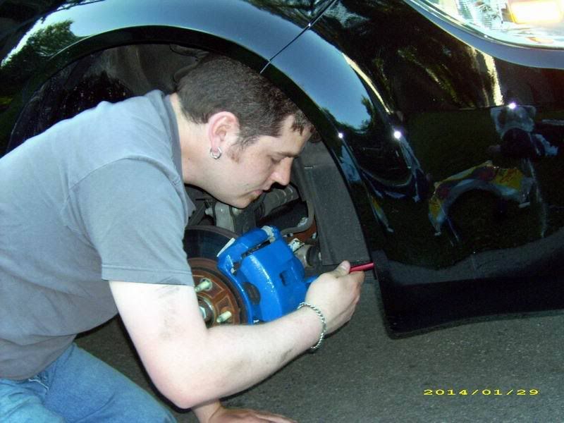

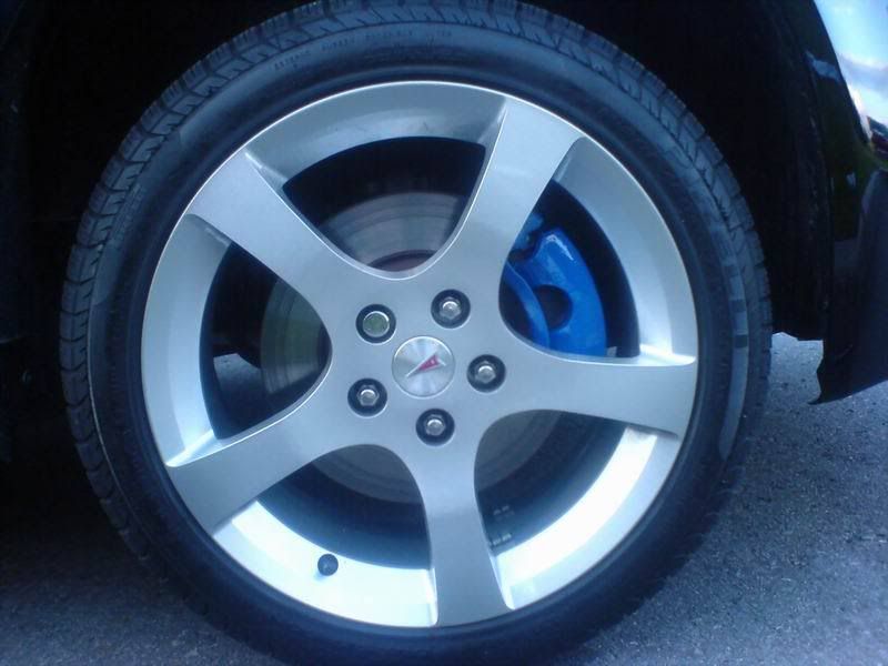

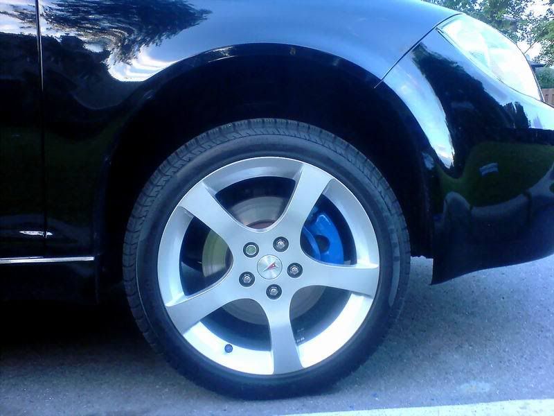

Heres what I did with my Sunday night. I am very pleased with the results. I will post some full car pics very soon. My cam died so the last ones are taken with my phone. Enjoy!

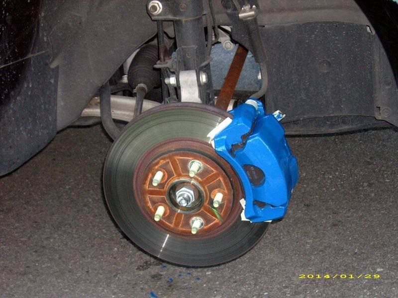

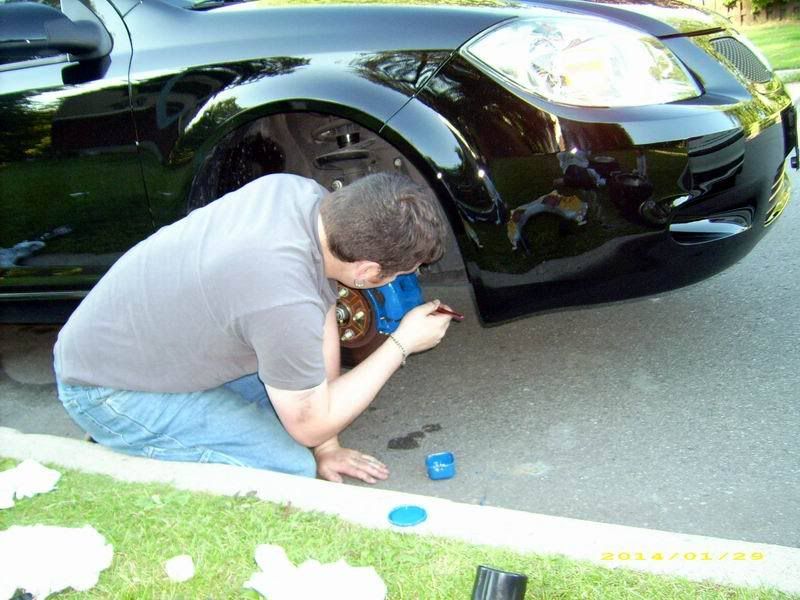

I just used the duplicolor kit from canadian tire. As for the prep, I used the caliper cleaner from the kit. I bought 2 steel bruches though and went to town on it. My car is still pretty much brand new so there wasnt much work. My friends 06 cobalt, however, was rusted to shit. After I used som windex to remove any dust that remained. I used windex because I needed something wet for the dust, but it needed to dry quick.
I put 5 thin coats on each caliper. Each coat took about 10 - 15 minutes to dry.

I like the painted calipers..... leaving them from factory and they turn a dingy color and don't ever come clean...... lol
Red calipers for a red G5 GT, makes sense to me.
