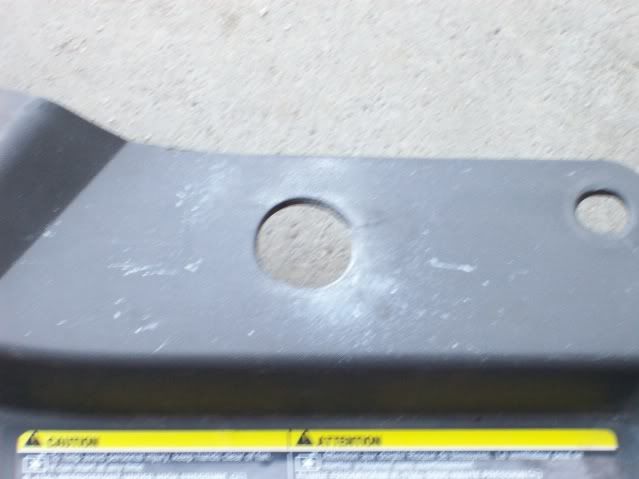

I received the grille (both pieces)
there was some sort of white crap on it.
the outer piece was black had a few scuffs when I got it but paint will soon cover it up.

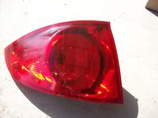

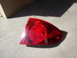

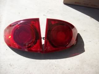

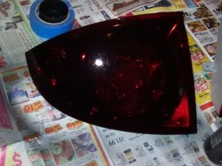

I received the g5 taillights. And the reverse lights heres the tails

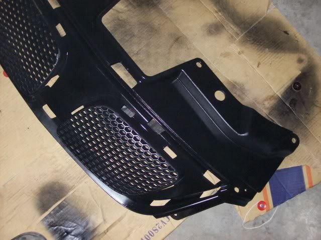

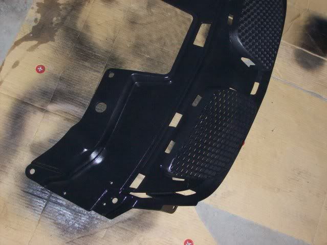

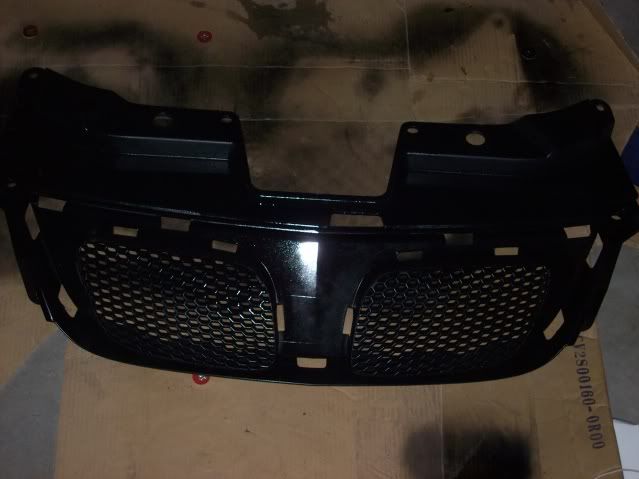

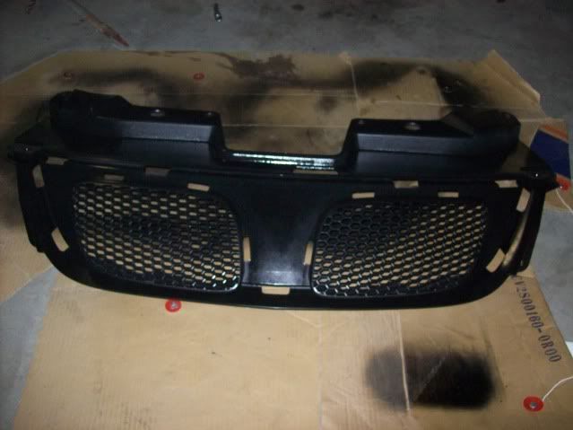

so I decided that I needed to paint the inside part of the grille black and so I did

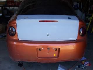

I finally get notice that my trunk has shown up at the greyhound station 45 min away… so I got it picked up. I have a trunk in my trunk………

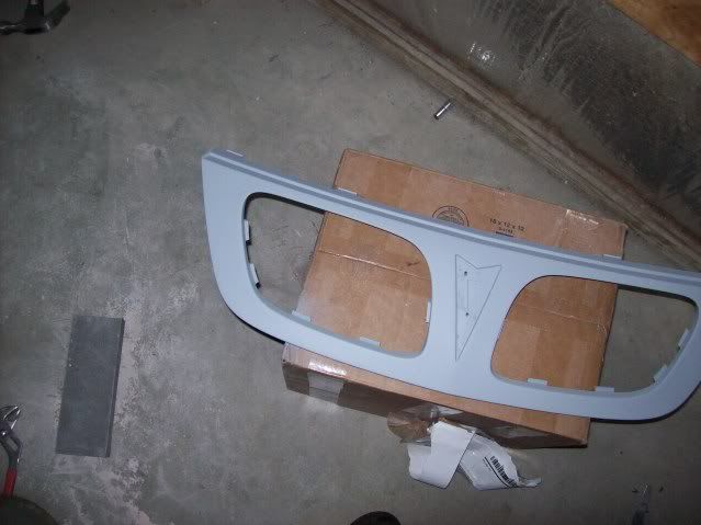

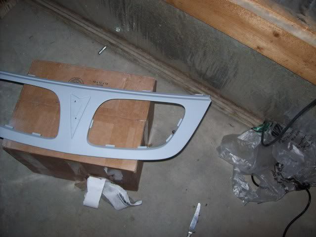

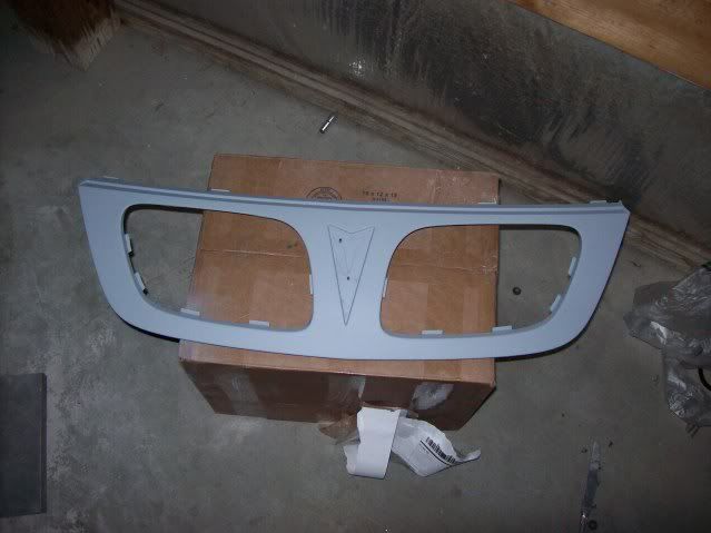

since I had already painted the inside of the grille I decided to get the outer part sanded and primed up.

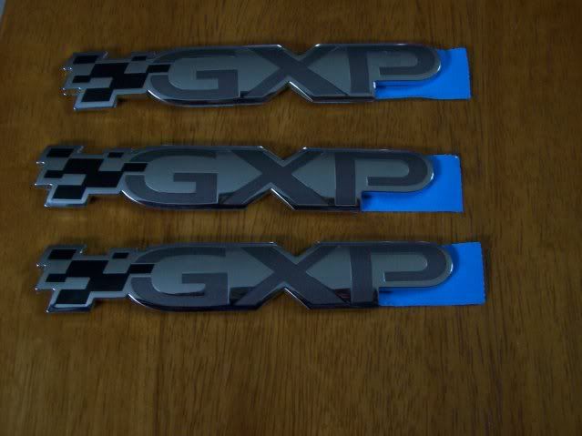

my gxp emblems arrived in the mail.

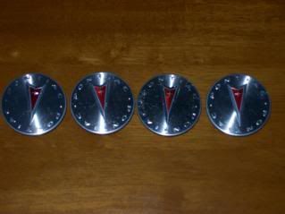

my pontiac center caps came in the mail:

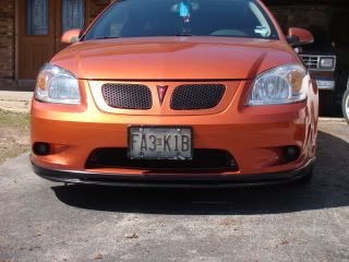

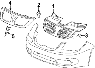

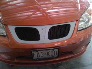

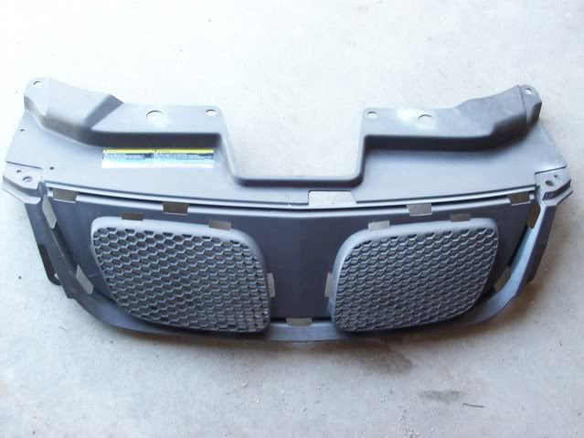

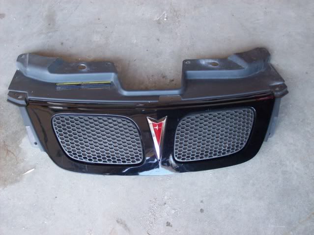

I then decided to make my grille fit and this is what I did:
1. what i started with was the left side of the crossbar and took a dremel to it and cut it
2. then i went to the right side of the crossbar and did the same
3. now under where the crossbar used to be located is three tabs.... i started with the left.
4. dremel the left side off
5. dremel the right side off
6. now you should have one tab in the middle and no crossbar
7. now install the grille and it should look like this
so now that I figured out all the business with the grille I can get it painted up

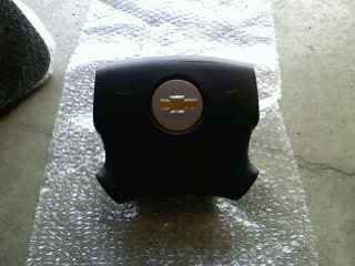

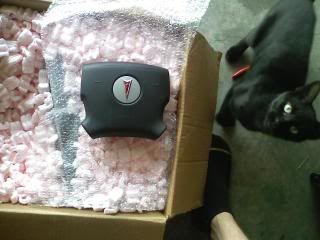

my new steering wheel airbag came in so out with the old:
and in with the new:

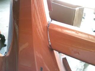

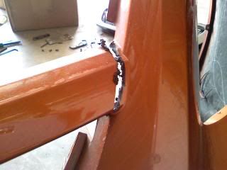

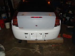

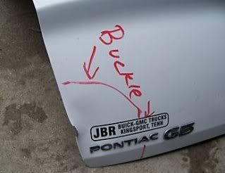

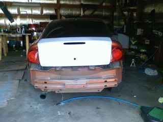

next up I finally got the trunk fitted( after a shit ton of body work) the corner of the trunk was bent at an outward angle…
got the ss rear bumper taken off and the g5 taillights installed:

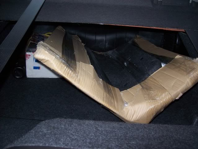

so since the reverse lights on the cobalt are located in the trunk lid, they need to be extended and rerouted to the new location which will be on either side of the license plate indentation.
when you remove the cobalt trunk there are wires for three lights: each reverse light and the third brake light. The different connectors on the end will indicate which is which. Since they are all in one loom take the wires for the reverse lights and separate them from the loom leaving the loom on the wire going to the third brake light… take these wires and add the right amount of wire. If you pull back the carpet behind my sub there is a grommet with wires already coming out for other electronics(kinda like the one in the firewall behind the pedals) feed them through it and route them to the new location using zip ties as needed. I found it to be easier to add some wire first then feed through the hole then add the connector back to the wires.( pictures are commencing in the camera)

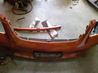

so time passes and passes and passes and I finally get my gt rear bumper at a great deal and I put it on:

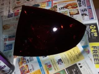

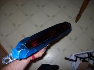

I have the taillights out to be tinted along with the reverse lights.
also I got the outer grille surround painted:

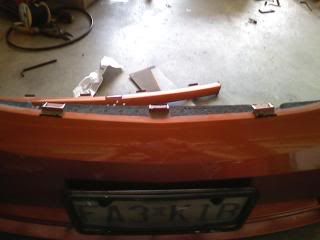

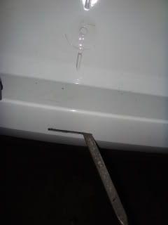

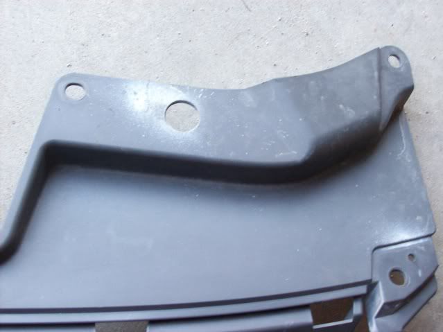

so now that I finally have this bumper that means I can fit the ss/sc lip to it. I know so other guys have had some troubles with getting it to line up correctly.
heres what I did…..

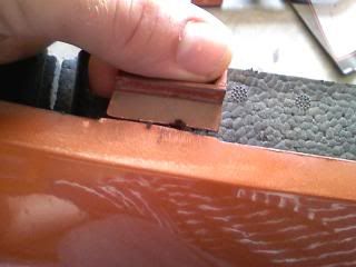

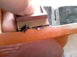

I took the ss lip and matched it up with the slits that were already there and there were some extras. I cut the extras off because I figured that if the g5 gt lip didn’t have them then the ss lip didn’t either. So now that I did all that it still wants to fit weird so
I took a small file and made the slits longer making there more wiggle room. As soon as ii did that she fit like a glove.
edit::just not quite the perfect glove.... to get the lip to sit flush with the ss rear lip you have to cut out part of the bumper where the rear fascias are soon as that happens it looks like its from the factory.

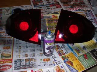

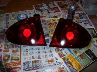

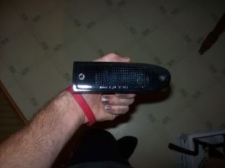

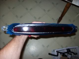

well I finally got the taillights and the third brake light and the reverse lights all tinted up:
got those tinted and these painted while I wait for the paint.
