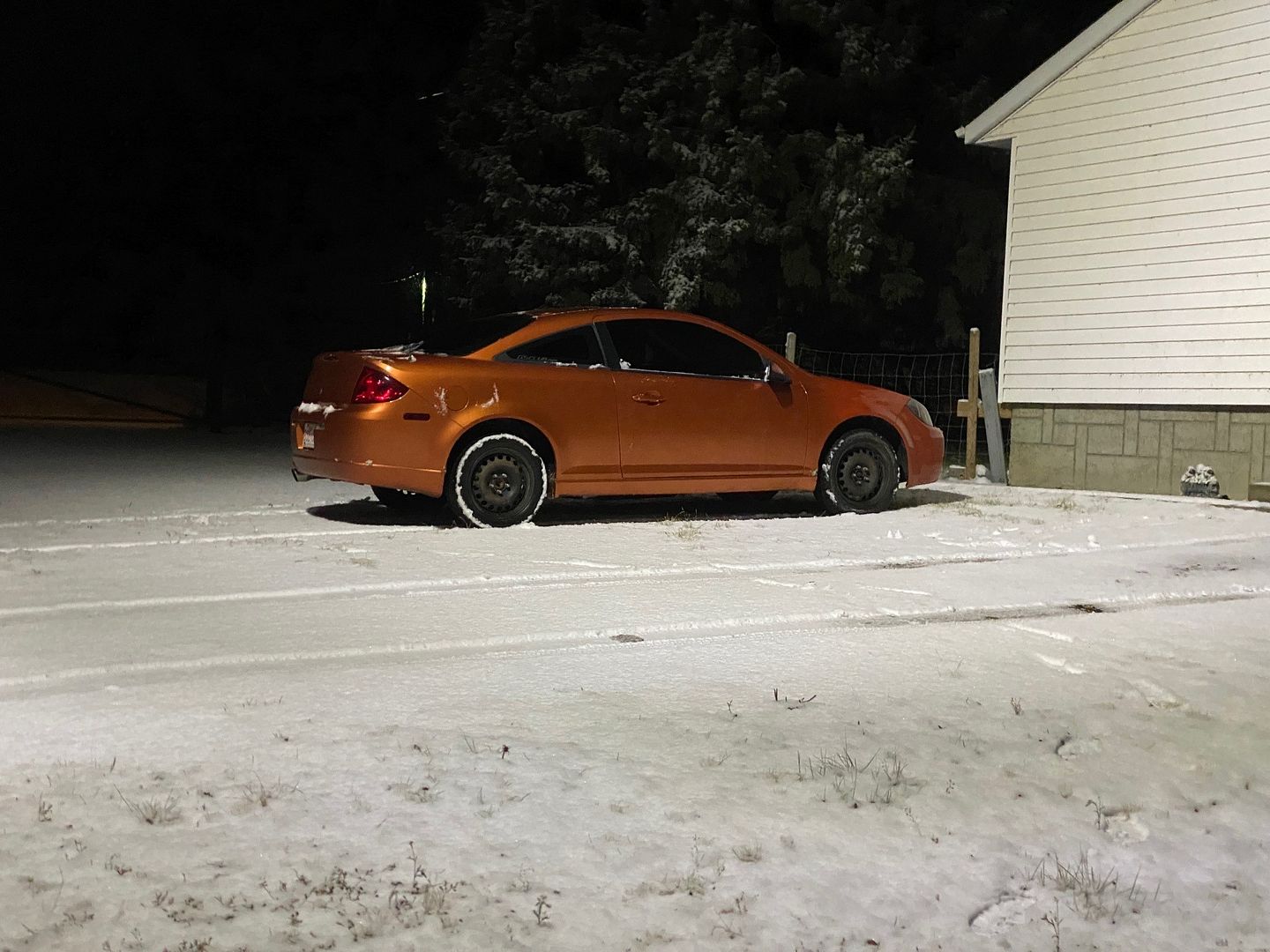

Long time no talk folks, but I am finally back in Canada, and rolling around in the old Pursuit GT
Basically I will be looking at selling it so need to repair a few items, mainly is the revs hanging between shifts.
Temperature of car doesn't seem to matter, once driving, if you let off the throttle it will hang for a second before dropping making shifting a bit of a night mare.
Has anyone else had this issue? car sits a lot but still seems to run okay otherwise.
Here she is in all her glory, lifted back up and no longer Turbo sadly, but still rust free.
