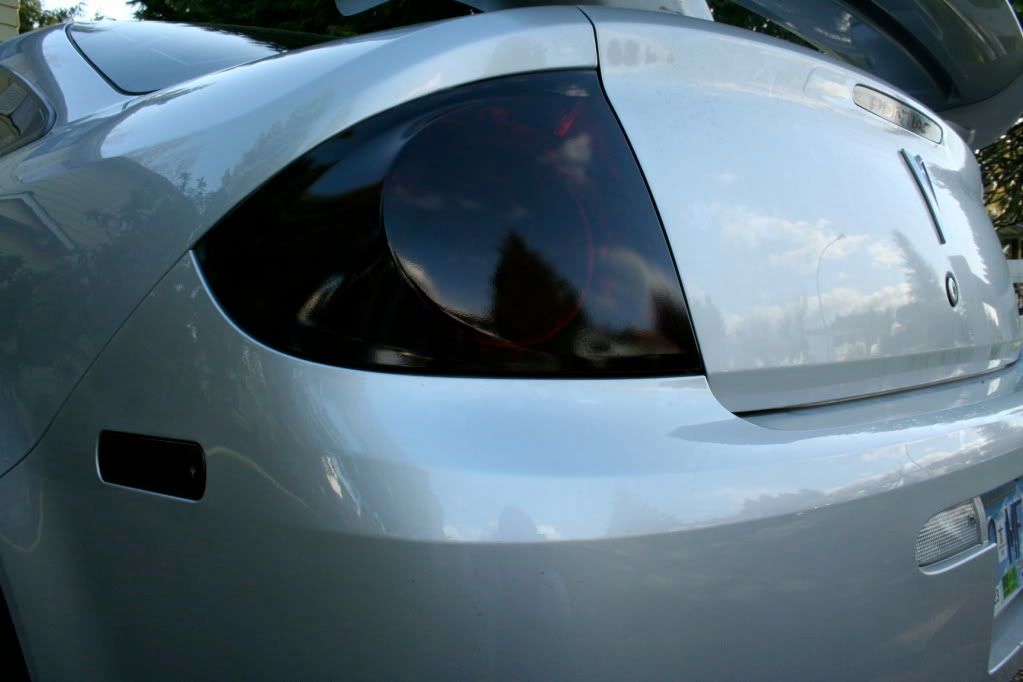

16.) ENJOY the beautiful darkness of your new tinted lights while ENJOYING a "factory like" shine of your tail lights
. I can scrape my finger along my tail lights now and nothing comes off! Its completely stock like!!! Looks tinted out of factory.

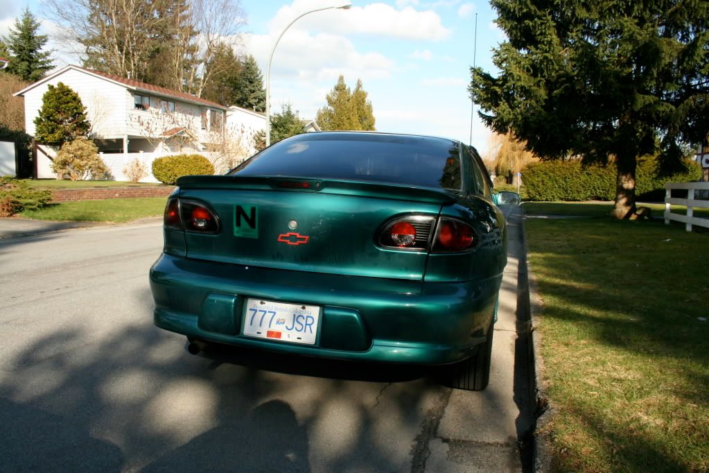

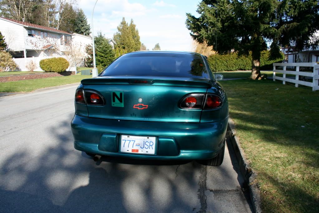

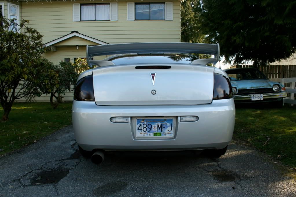

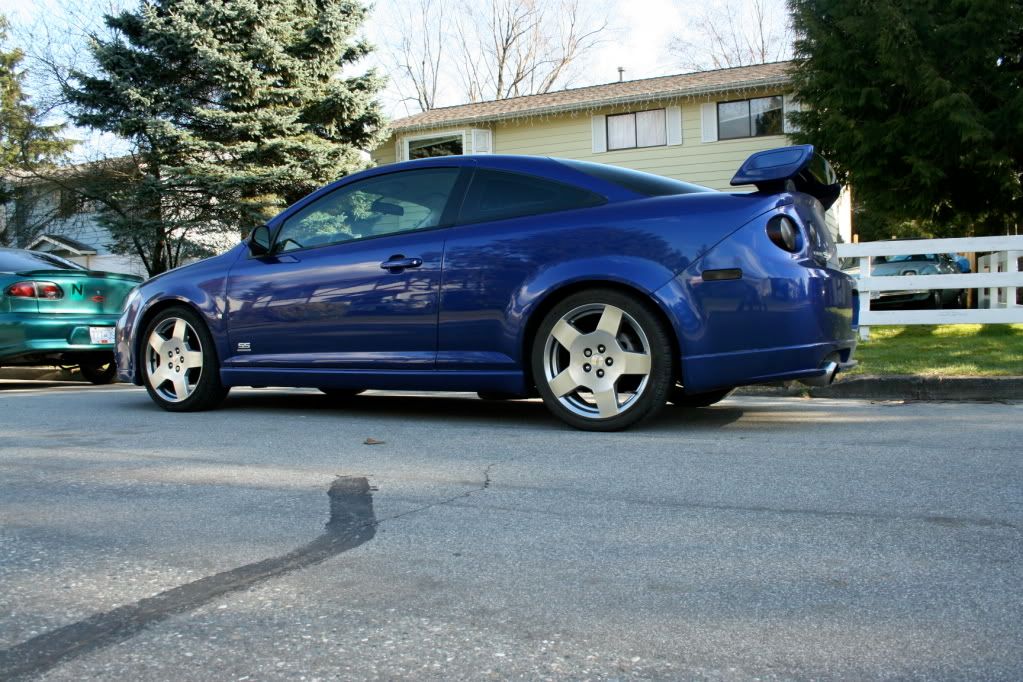

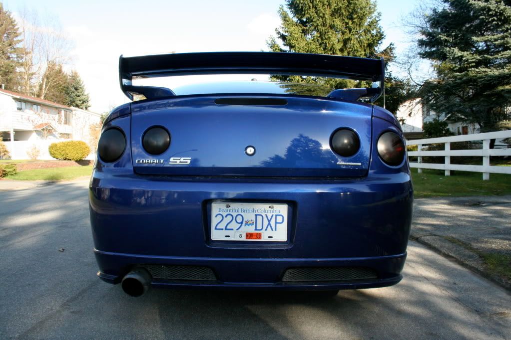

Mine (I redid them
looks much better now!!!):
Kiwi's:
Brad's:
