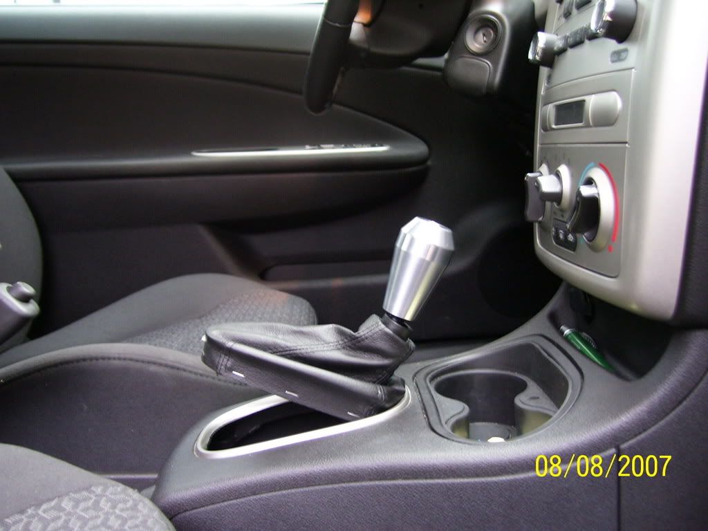

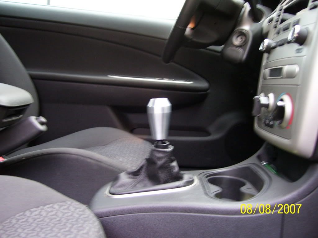

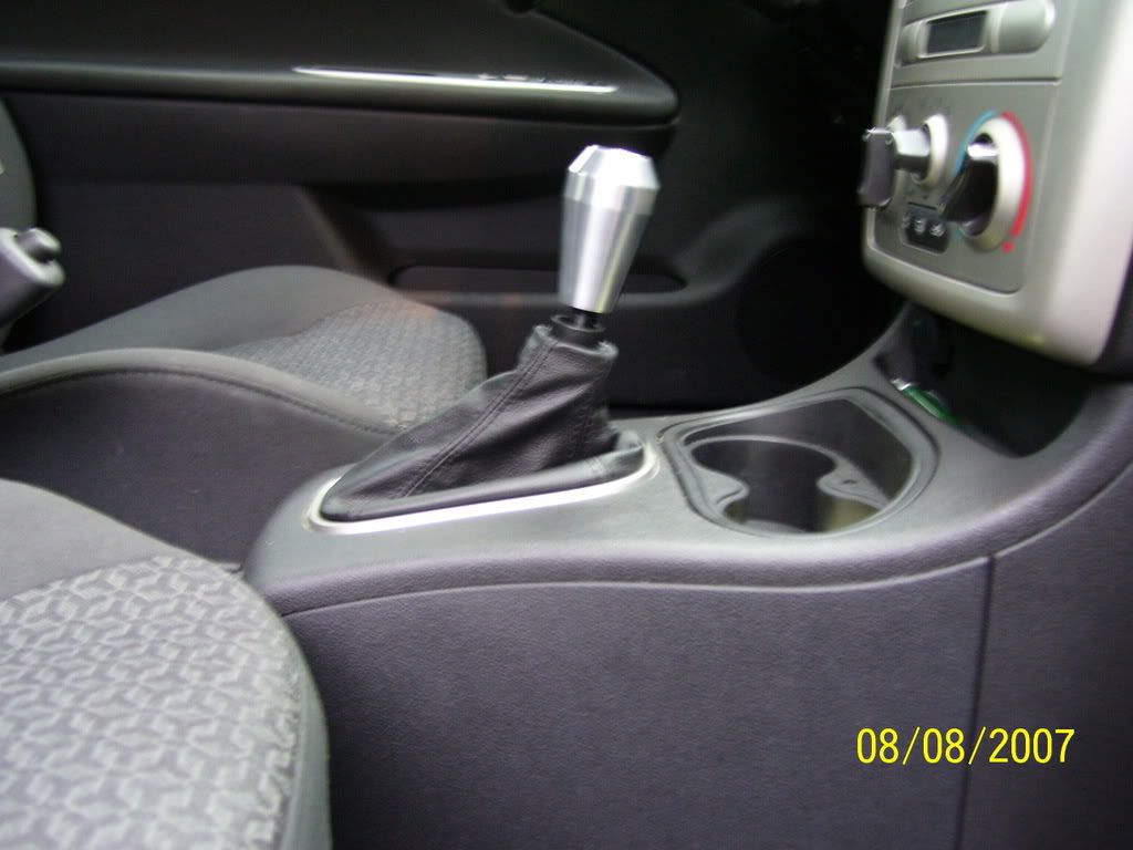

dunno if this is the right section for this but i just installed it on the weekend and i have a problem, all the shifts seem too high in the throw ill use picts to demonstrate my point
Neutral
1st[/img]
4th
4th looks like where neutral should be and 1st is way too high so high that it pulls the shift boot out. anybody else have this problem and how did u fix it?

When you re-attached your shifter cables you did it wrong. Someone post a picrture looking down on the shifter so that you can see the cables and i will explain it.

i do have all the other gears working as well but i just decided to give picts of those to show the position of the shifts.
there is a pict of the cables in the instructions to install but i just cant seem to find a way to post the pict on step 13
